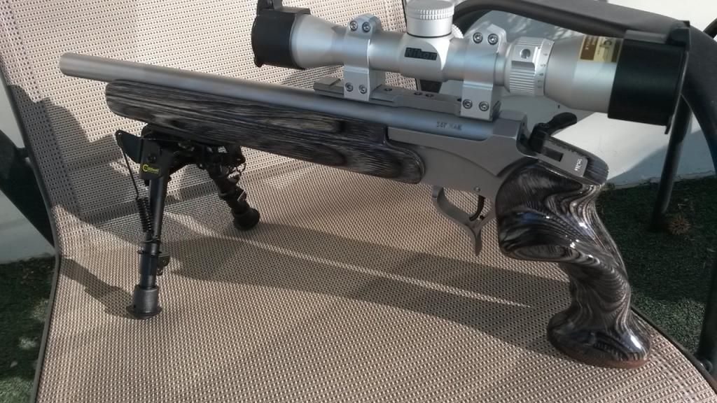

I just dove head first into 357 max in an encore for Hunting deer in Illinois. I've got about 700 new unfired brass and 500 different projectiles and I'm rolling my own. I've loaded up some test rounds and getting ready to do some shot grouping. I have some 158 gr and a lot of 180 gr projectiles to test. In a state were straight wall pistol cartridges are legal the 357 max makes the best sence of all for it's flat shooting and capable energy of knocking down a deer at 200 yrds. If only I could do my job at that range would I ever consider taking a shot at that range. Below is a picture of my encore in SS with an MGM barrel and a Bellm chamber. I also sent it off and had the trigger set to 3 lbs. It's sporting a nikon scope and a Caldwell bipod. Most that shoot the 357 max love it, but the round got a bad rap in the 80's from being loaded with too light of a bullet and shot from revolvers causing flame cutting on the top strap. The round wasn't designed for light bullets and really shines in the 180 gr pill'
